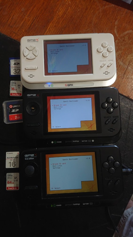

I thought I'd post this up since it's now feature complete (at least enough for a first release).
I've written an entirely new GP2X bootloader from scratch, which can do a few things the original u-boot can't like loading bare metal executable files (more on this to come), kernels and even other bootloaders from SD. It may even be a little faster to boot.
You can still boot (directly if you wish) into whatever Linux firmware you like, and flash new kernels to NAND. This isn't exactly a new release of the Open2x firmware, just the bootloader.
One binary works on all GP2X models, both F100 and F200 (NOT Wiz, Caanoo or F300).
Of course you can brick your GP2X installing this, and getting JTAG working to recover them seems easy on some units, horribly unreliable on others, so you do so at your own risk.
Download gp2xboot.img here: https://github.com/Orkie/open2x-bootloader/releases/tag/v1.0
Instructions on installing and use here: https://github.com/Orkie/open2x-bootloader/wiki

I was on Open2x DR7 and installed your new bootloader today. It installed fine, thanks.
Curiously one thing now happens that never happened before. In Open2x I use the music player often (Gmu), but now after installing the bootloader any song I play in it becomes choppy the first few seconds into the tune. At first I thought it was an SD card issue so I changed the card, but no, it is the same no matter the card (2GB or 32GB). However, if I go into compat mode and play the music with the default player they play fine.
Any idea why this is? Gmu worked perfectly right before installing the bootloader.
EDIT: Yeah, if I use one of the patched .o2x bootloaders the music plays smoothly in Gmu! I opened an issue on GitHub in case you do not see this message!
