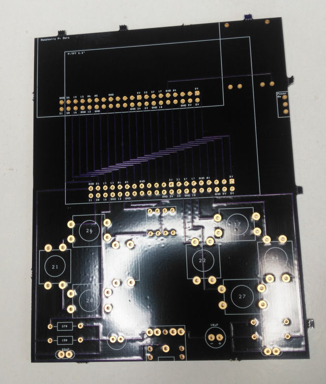

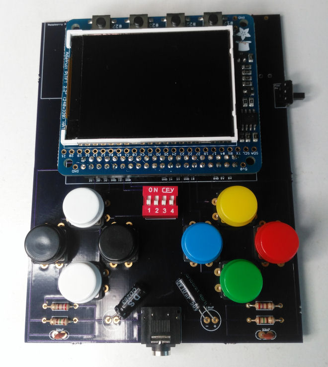

I struggled with KiCAD, but I managed to build a few boards using DesignSpark, then getting them manufactured at OSHPark.
Here's my latest endevour
