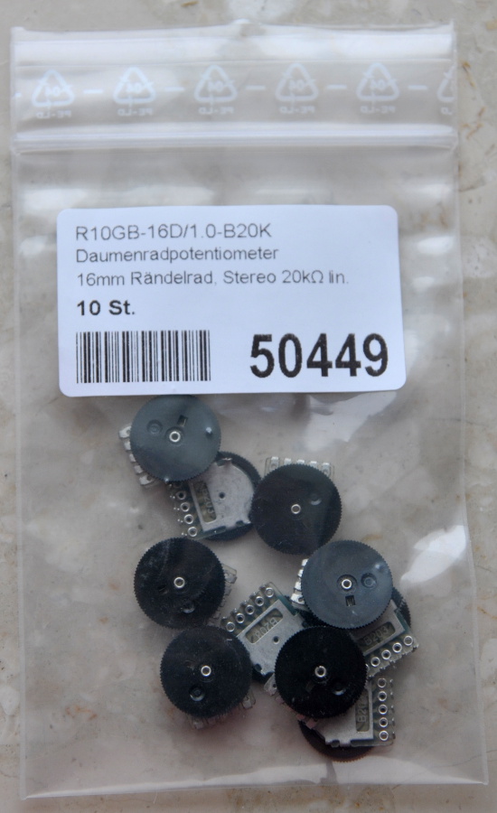

Thank you. The full part number would most likely be R1001G21A1-B20K/φ16×2.8. I will contact the representatives of the manufacturer, that are close to me, and see if I can buy some.

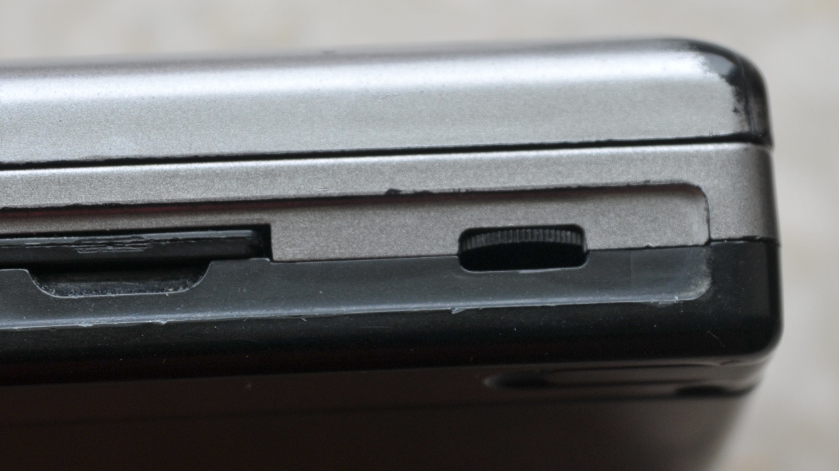

Finally! I was able to order the potentiometers from a German distributor. Unfortunately they didn't have that exact model, but a very similar one - with smaller wheel and bent pins, so I had to do some pliers work. And now I have 10 of them just in case :) (they didn't want to sell me less).
It doesn't look beautiful, but it WORKS :).

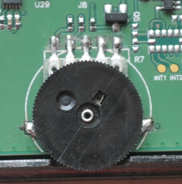

The broken potentiometer apparently had a crack between the resistant layer and the pad. Though not visible, while measuring the resistance it suddenly went infinite when moving the probe by the track. So definitely not a wear problem. A random failure I would say.
