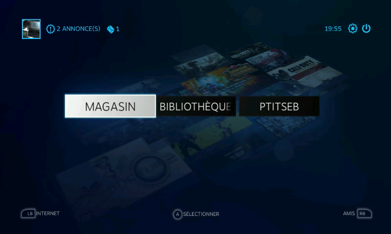

Here is Moonlight, an open source implementation of the NVidia GameStream Streaming Protocol.
A video on Moonlight (embedded) running FEZ
With it, and using an NVidia equiped PC, you can stream your PC Games to your Pandora.
Problem is that the Pandora power and Wifi make it slow to render the PC Screen, and add some lag, making that software not super useable.
To be able to use the native Pandora resolution, you may need to create the 800x480 as a custom resolution in the NVidia control panel.
But I guess for Turn by Turn game, it may be usefull...
