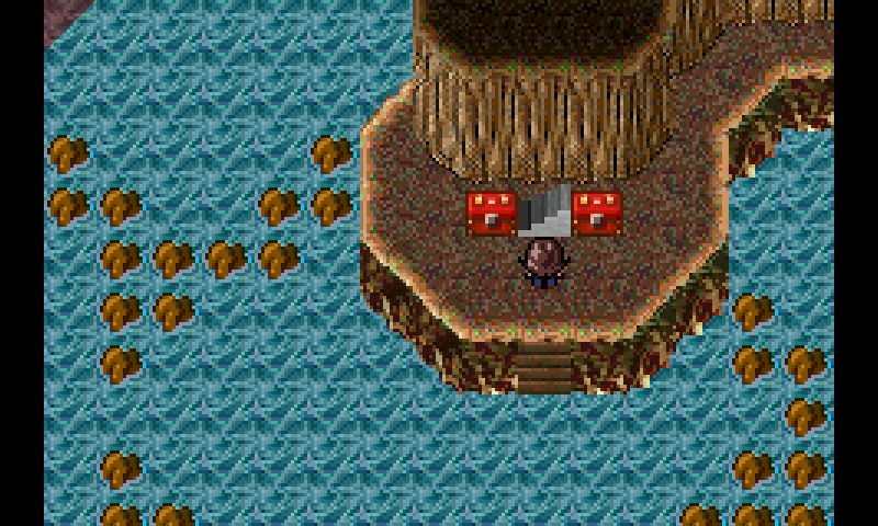

Here is Monter2Rpg, an RPG with Monsters...
This one use Allegro5. I used a newly ported allegro5 to GLES2 this time, so you have shader (like shadows for example). It seems this port of allegro is a bit a slow (it's not very apparent on Gigahertz model, but you can feel it on a CC). It's fully playable and enjoyable (and it's not an action game).
I had many issue, and had to include a few hack to make this one run (to make it exit properly, and to make it launch on CC model). But it seems to be working ok now (I haven't tested the download of the HQ music but it should work).
