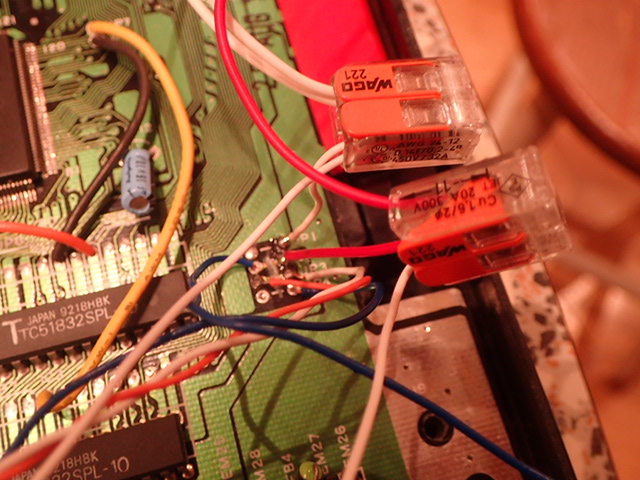

I got +5V and GND at the region jumpers (random cable colors, I have to resupply):

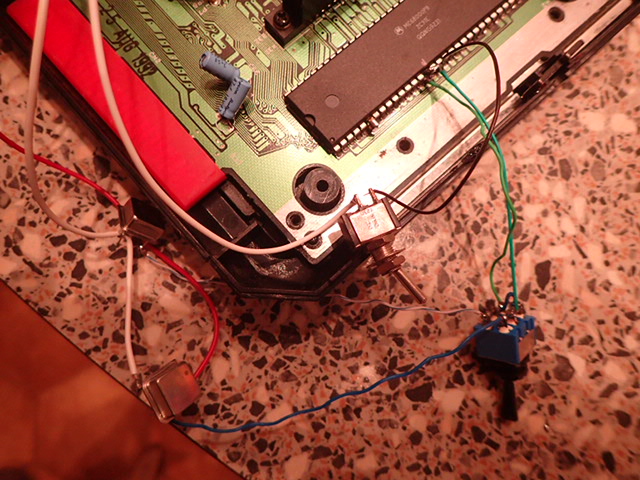

Oscillators, switches, and the Almighty 68000 on steroids:

I shortened the oscs<->switch and switch<->CPU cables, and soldered the clock switch casing to the gnd.
It helped as it takes more time to crash ! But I didn't found a 12MHz playable game. Most of the time, the colors go weird and at best the game resets.
I could try to solder the clock pin of the oscillator directly on the switch, but I'm good with 10MHz. Everything work well so far, and the games which are enhanced have no more slowdowns.
