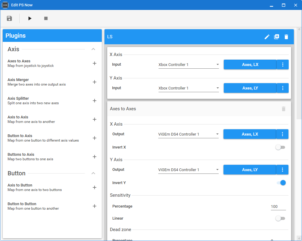

What you are saying could be obtained only with virtual gamepads, where you can associate to them every physical device you want. (With vJoy for example, you can create a virtual joystick made by the sum of 3 different physical controllers...).
Nothing can stop you from using a virtual gamepad in conbination with devreorder anyway... for example to let be visible only the virtual gamepad to a program.
