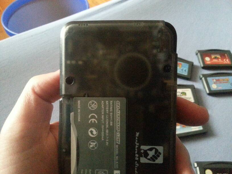

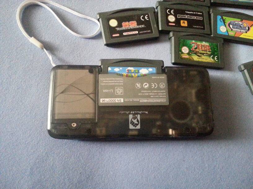

I wants a transparent case like on my K101 plus..
We need to crowdfund one of these for EvilDragon, make some Titanium or stainless steel cases.
@matzesu once the mold is there, use glassfiber instead of carbon and it should look simmilar. Would test it with glassfiber anyway, costwise.
