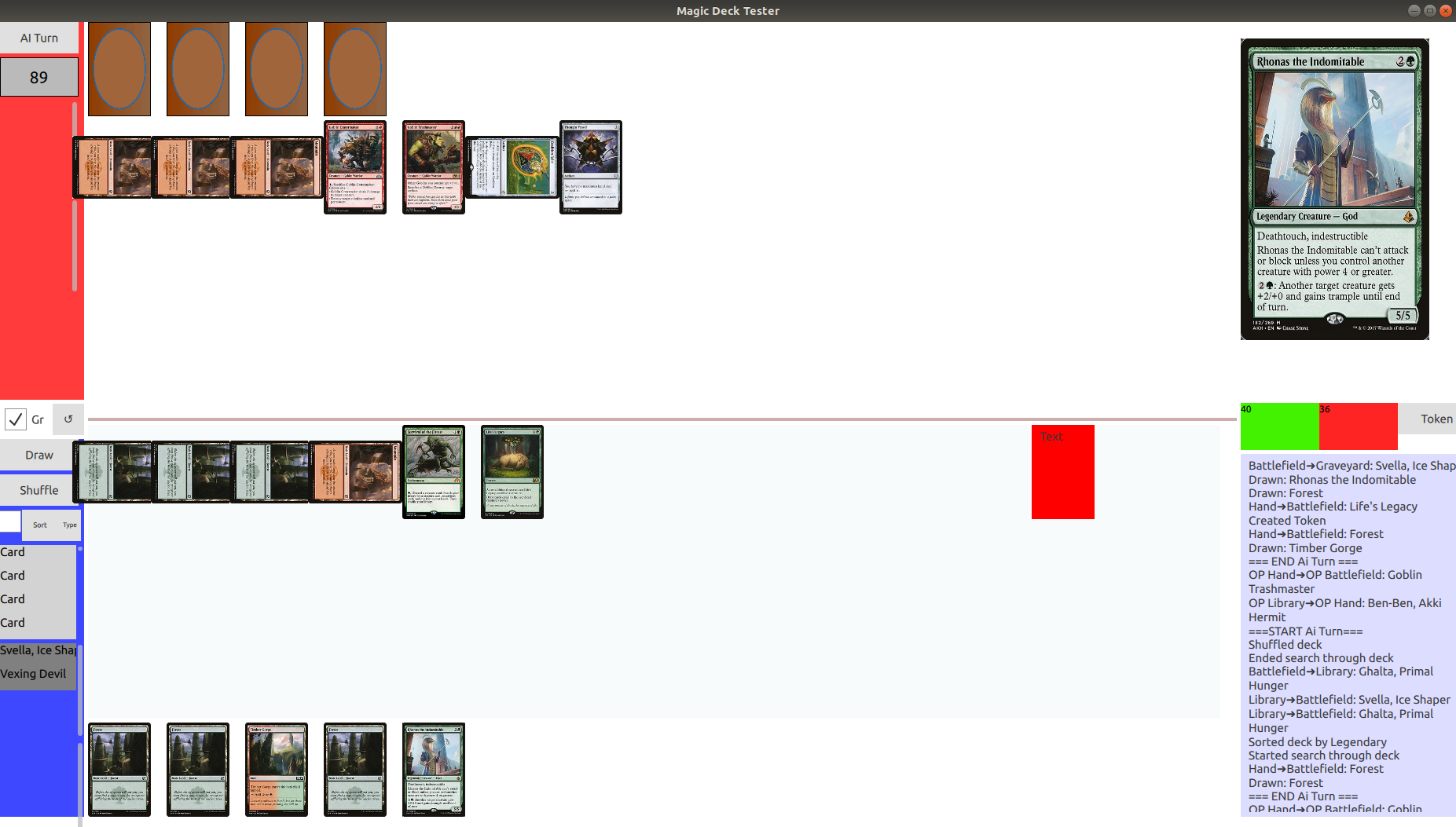

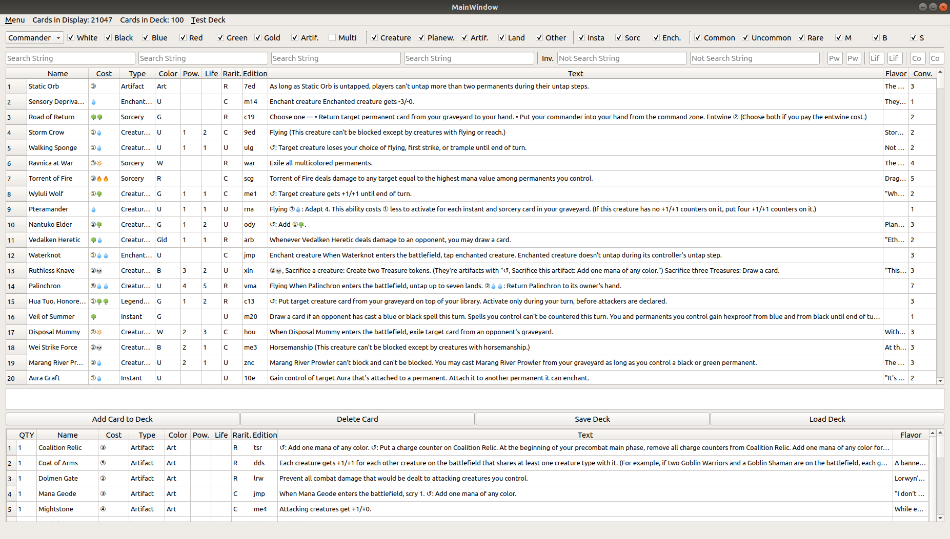

I wrote a magic the gathering deckbuilder and a deck tester. You can play against a (stupid) ai, create your own decks, print proxies and filter by color, type, string, not string and rule set (commander, modern, etc). It is opensource but yet unreleased. I could use beta tester, bug hunter for a nasty deck builder bug and maybe co developers for replacing the AI with network code for team play.
Is there interest in this software from the pyra community?
It is written in pure qt/c++/qml and has only qt as dependency.

Here are the files. Thank you for testing :). I could realy need someone who can design UIs. I won't be able to look in this thread until monday.
Instructions are: build the project files with qtcreator. Just open the project file of each zipfile. It needs qt5 and wifi (to download card images).
testproject: Deckbuild
qml-master: Decktest

Controlls:
Left click: play card, tap card (on field)
Shift Left click: return card to your hand
Right click: discard card
Middle Mouse Button: Put card to library
GR Button: means group automaticly
Sort: Sort by name
Type: Sort by type

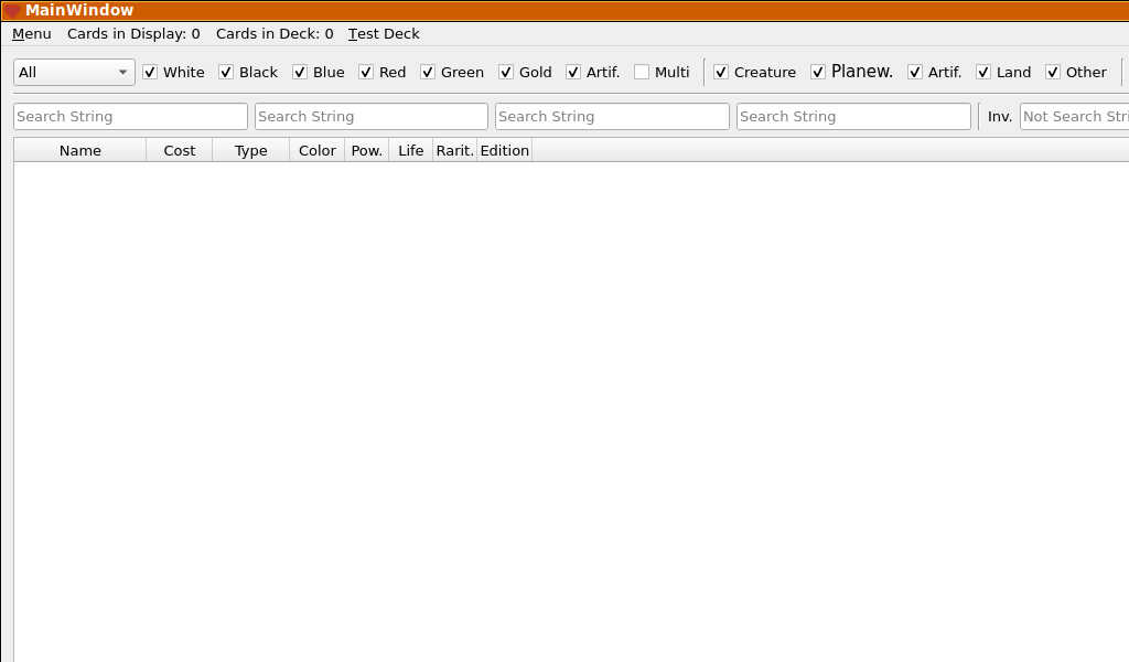

Okay, I've finally found the time now to install qtcreator. Building it was pretty straightforward, and having built it I'm able to run it. Unfortunately, running it gives me a window that's far too wide for my screen, and the following is spat out on my terminal:
Code:
Couldn't open save file.
Cards which should be displayed:  0
"No such file or directory"
cd /home/rohezal/projects/magicnet/build-magicnet-Desktop-Debug; ./magicnet `pwd`/ &
sh: line 1: /home/rohezal/projects/magicnet/build-magicnet-Desktop-Debug/magicnet: No such file or directory
Seems you have some paths hardcoded in there.

Thank you for testing. I was afraid the window was to big for the Pyra. The line appears if you want to start the deck tester from the deck builder.
Optional:
If you want to start the deck tester from the deck builder change the path in:
void MainWindow::testDeck()
system(( QString("/home/rohezal/projects/magicnet/build-magicnet-Desktop-Debug/magicnet ") + lastLoadedDeck + " &").toStdString().c_str());
Alternatively you can start the decktester (magicnet) via
./magicnet PATH/TO/YOUR/DECK
For the size of the screen, I have to come up with something. Is someone good with QT Guis in the board? It should stretch depending on the resulotion of the screen. Maybe even change from a one row layout to a two row layout.
Can you post a screenshot how it looks like on the Pyra?
I don't have a Pyra, but I'm testing this on my eeePC which has a slighly lower resolution than the Pyra does, (1024x600 versus 1280x720).
I had previously unpackaged and built testproject-master since that looked the more promising name, however that builds a project called cute_magic. Qml_master builds magicnet, but that doesn't run for me, and debugging in qtcreator leaves with a debugger exits code 377.
But in any case, cute_magic looks like this:

Cutemagic is a deck the building software. You need to download cards.7z and unpack it into the build directory of the cute_magic
Magicnet is the decktester. It needs as first argument the path and name of the player deck. It uses for the AI aigobo.deck, which needs to be in the same folder as the player deck. You download premade decks from the post. Sorry for making it so hard to install and test.
./magicnet /path/to/playerdeck.deck

Controlls:
Hand:
Left mouse button: play card
Right: discard card
Middle: put card into library
Field:
Left: tap card
Right: send card to graveyard
Middle: send card to library
The problem with the window size sounds bad. Looks like I need an UI guy to help with a resolution indendend interface. Thank you for testing :).
