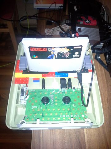

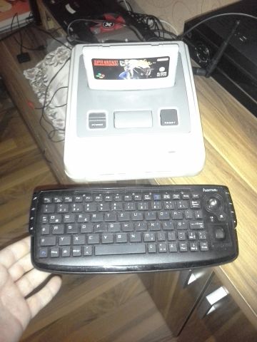

Build it in a Super Nintendo Case with a Retrode2 like my old Idea: :)
https://forum.gp2x.de/viewtopic.php?f=23&t=17531&p=205575&hilit=snes+projekt#p205575
Nice project :)
