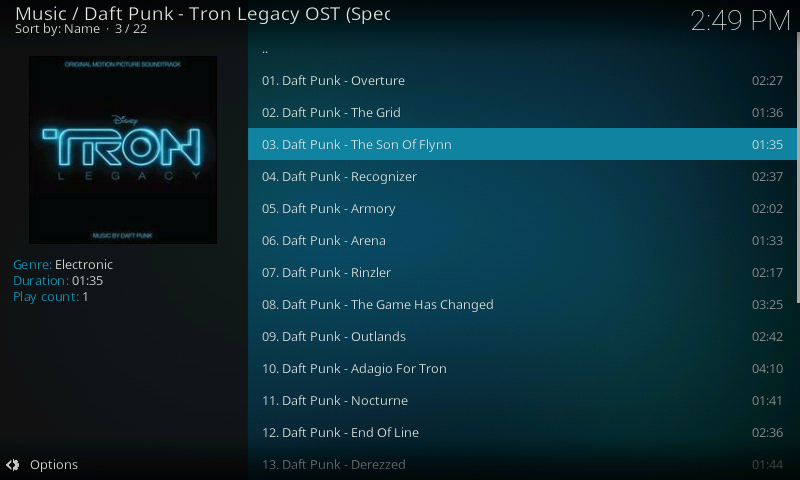

Here is Kodi (formerly known as XBMC), the Media Center.
The Software is fully functionnal, works with 3D acceleration, and is usable on CC, Rebirth and Gigahertz (of course, it feels more snappy on Gigahertz model, but it's usable on the whole range of Pandora without Swapfile).
A word of warning if you want to try to Stream things: the internal Wifi doesn't seems to be good at that, and a Wifi dongle is strongly advised.
(to get both Music Visualizer, you will need to enable them in Setup/Add-ons/My Addons/All first)

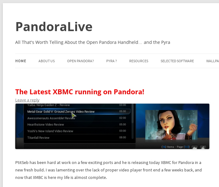

XBMC is Featured on Pandoralive: http://pandoralive.info/?p=3287 :)
