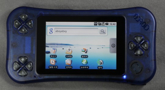

I didn't take any photos, funny story... my only camera is on my phone, my phone is running a hacked version of android 2.1 and the camera doesn't work atm, if they fix that I'll post pics but it very much looks like this
but more of a black finish, same transparency.
I wouldn't cancel (and didn't cancel) my pre-order, it's not quite "there" yet, but has great potential. I had the expendable money and it looked like a cool project to get into while I wait for my pandora.
