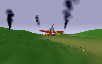

So this is my first PND release to the repo: Fachoda-Complex.pnd
Since It's being actively worked on by rixed, I will try to keep this up to it's current version.
Fachoda-Complex is a flight simulator/arcade game for Linux, tailored for small hardware configs.
I have two executables, a low-res 400x240 upscaled (600mhz min) and hi-res 800x480 (native resolution) which needs at least 800mhz to work properly, there will be ground clipping issues if you run any slower.
Since this is a flight sim game, it has a ton of keys to deal with, I made them as Pandora friendly as I could. The Nubs/mouse is used for control, but can be configured in keyboard mode to use the D-pad.
