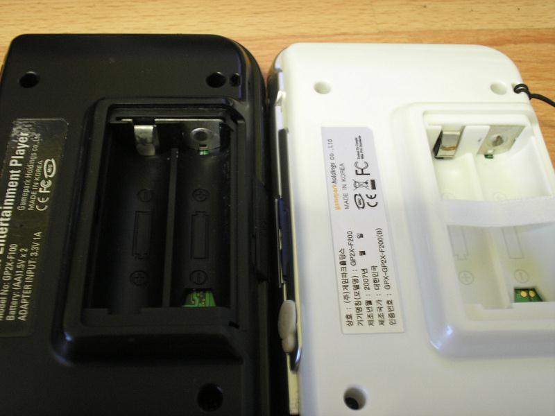

They are not really springs. They're more like a V shaped pair of prongs in mine.
I've never used an f100.
Here's a quick photo of my F100 and F200 -
They look pretty much the same to me.

Thanks for posting the pictures, they are exactly what I wanted to see. It's very disappointing. This battery compartment is the worst design I've ever seen. Even el-cheapo made in china toys have springs that hold the battery and I can't, for the life of me, figure out why they went with this design.
Does anyone know of a way of improving this short of removing the existing tabs and installing springs? I have tried to heat up the tab in the spot that it bends while bending it out, but without the ability to get it glowing hot and then shock it with cold water it doesn't work. Any ideas?
