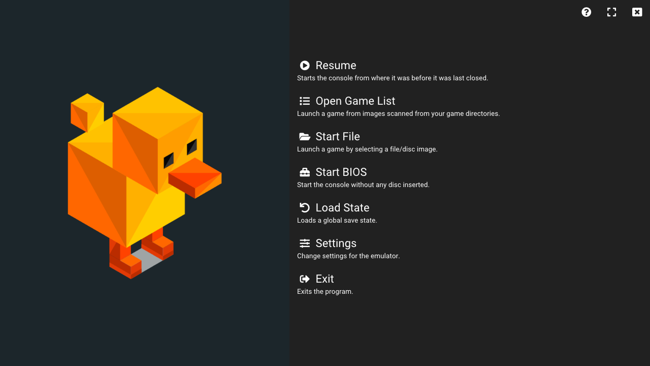

Here is DuckStation, a PSX (PS1) Emulator
The Emulator needs BIOS to run. Copy them is "appdata/duckstation/.local/share/duckstation/bios" after 1st launch, or use the setup to point to the folder. While in the settings, also setup you folder for Disc images. After that, most other config should be good to go for the Pyra.
Note that, for now, only the Software renderer is availble. Hardware rendere use GL 3.0+ (with Integer VA and UBO, so, quite some work is needed in gl47es before it could be supported).
The controls should be plug'n play. A Analog Pad is emulated, including the Rumble :) !
Also, for your future SDL2 port: here is pyra configuration to have the gamepad found
Code:
03000000010000000100000001000000,pyraInput Gamepad,a:b3,b:b1,x:b0,y:b4,back:b10,start:b11,leftshoulder:b8,rightshoulder:b9,dpup:h0.1,dpdown:h0.4,dpleft:h0.8,dpright:h0.2,leftx:a0,lefty:a1,rightx:a2,righty:a3,lefttrigger:b6,righttrigger:b7,platform:Linux,
Use "Space" to validate stuff while in menu.
And to get the menu while in game, use "F1" key.
(it sometimes fail to get fullscreen. In thta case, just quit and relaunch).

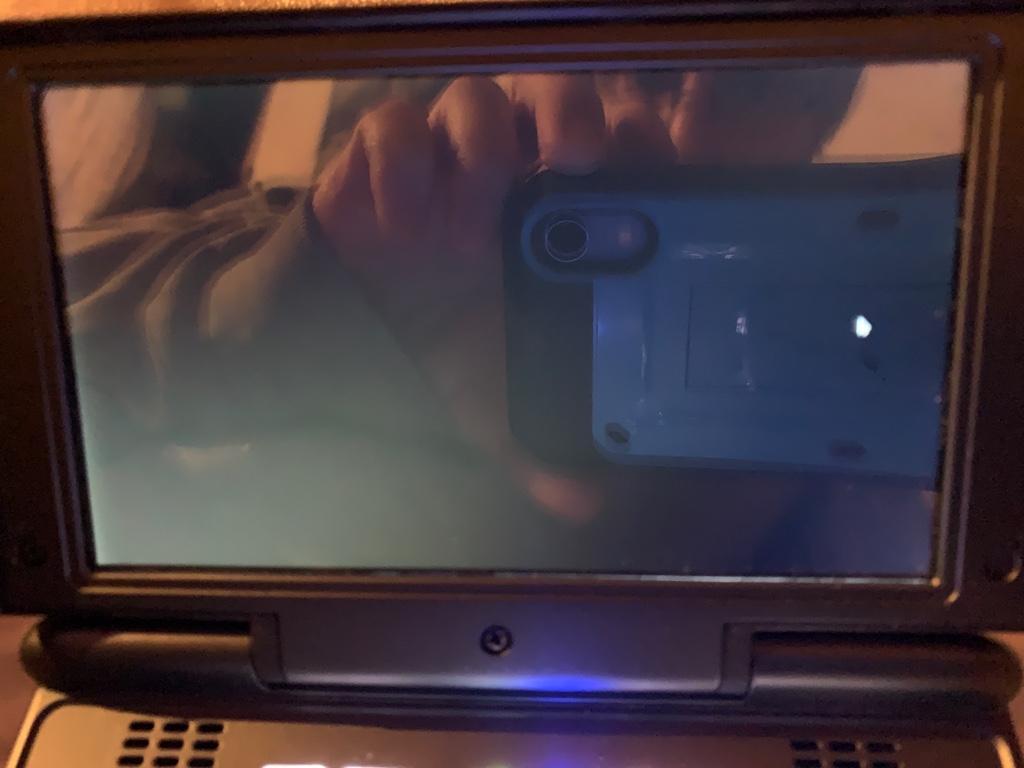

Now build on the repo, a qui-repacke to use gl4es and hopefully fixing the blackscreen on start.

And I found out the Game List don’t put any of your games on it’s list, but you can go manually to the directory and run them from there, if the game file is a different type..
but it’s a bit work as you have to go the whole path when you use this way: /media/matzesu/pyra2/pyra roms/PlayStation X but it’s the fault of the emulator ui, nothing you can or should have to, as it’s up to the user who have its image in a non standard ending
Are you game directories not configurable in the settings? I have no experience of running this but looking at the screenshot above I suspect it might, and that might fix your game list.
There are, and I allready put the PlayStation Directory right, but some games like Afterburner and the Final Fantasy Games ditnt got to the Game List..

Images that aren’t listet can be played over (Start Image) , but needs some more steps as you have to go the whole path from the Apdata of the Emulator, to your Rom Directory..
