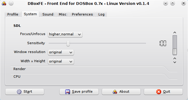

Hi all,
I compiled this frontend for dosbox a couple days ago and it works good. The bad part is that it doesnt fit the pandora screen too well, we can drag the window around to see what we need to see. But it would be better to have something designed for 800x480. Im putting out a request to someone experienced with Qt to redesign the ui to fit.
Im willing to work with anyone willing to work on it.

I did take a look editing the ui's with the Qt creator and Monkey Studio, and i can say the experience was quite annoying, maybe I dont know it well enough yet but the auto-layout seemed to think it was smarter than i was. The autosizing of the controls was driving me crazy.
There's a reason for that. Qt requires you to plan your GUI well so that it becomes scalable (ironic, isn't it) and it isn't made to allow you to just drop controls randomly with absolute layouts...
I'll take a look at the code myself, see what I can do, if lulzfish doesn't report back soon...

When I say the "main layout" I mean that I've redone the whole layout from scratch, and have gotten the thing to compile. I'm now working on making the layout as dynamic as possible to make it fit in as small a space as possible. Oh and I'm only talking about "dboxfe.ui"; haven't touched the others as they seem to be OK already.
EDIT: WIP screenshot:

Dude, I'm just porting the UI of an existing app to the Pandora's screen size, nothing fancy (read the first post). All creds go to the original DOSBoxFrontEnd authors
OK so here's the patch of what I've done so far (to be applied on the SVN trunk). Had to fix some code as well because of 1. compatibility reasons (it's a new UI after all) and 2. my compiler is in strict mode and didn't allow non-standard C++.
Tell me whether it's "good enough" or if I should optimize some more (I used form layouts quite a lot, and they waste space under certain circumstances)
Patch:
http://www.mediafire...php?nqoyttjzjnm

dflemstr great job it fits just right. Right now i dont see anything that needs to change.
