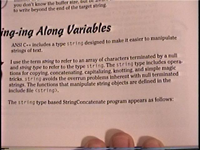

The middle paragraph confuses me. I get confused on which string he refers to in the paragraph. Which one (the string that's refers to an array or the type string) "includes operations for copying, concatenating, capitalizing, knotting," and which "one avoids the overrun problems inherent with null terminated strings?"

string: is an array of characters terminated by a null character. This is waht most of us are referring to when we talk about a string.
String type: This is a specific class in C++. It wraps the concept of a string in a class that provides many operations such as the ones referenced in the book.

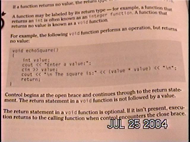

Ok, I think I may have grasped the concept of functions incorrectly. Are there set functions, like specific ones for doing specifc tasks? That's how I thought it worked, until I saw these two pics. They both are functions that square a variable, but one is called "echoSquare" and the other is called "square." What's up with this? So, there aren't specific functions, you just name them whatever you want, and the only thing you need to worry about are the function arguments, return type, and what's in the function body?

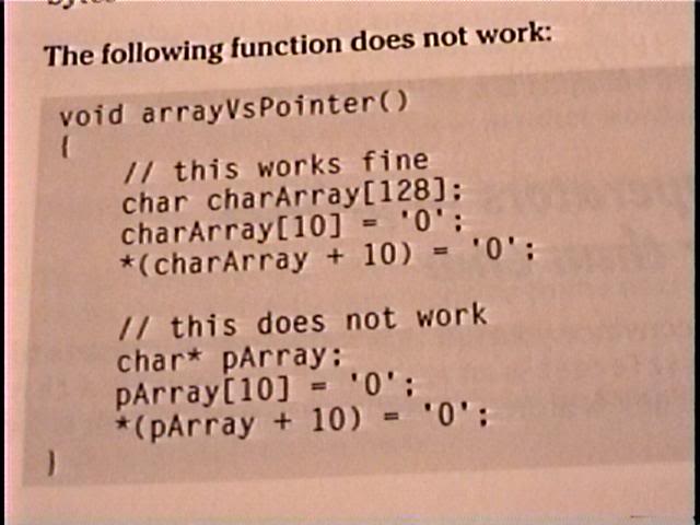

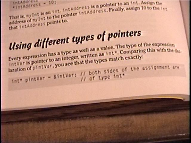

Okay, I spent A LOT of time on this one and I still couldn't figure it out. I'm talking about the line of code in the first pic, and the first parapgrah and line of code in the second pic. How's &intvar assigned to int*? It's not a pointer, from what I can tell. The second pic, the first sentence doesn't make sense at all (along with the code, but of course, if I understand the first sentence, I'll understand the code). I agree with the first half of the sentence, but the second half just doesn't seem true.

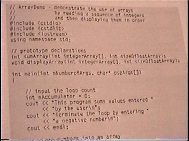

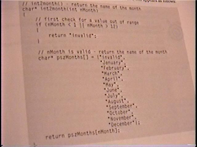

How's this work? I mean, would this code really work or is it missing something? How would the user input nMonth? Am I missing something here or would this just not work out?

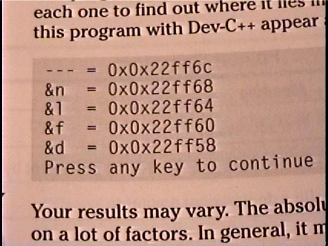

I'm guessing this is a typo: The second to last sentence in the second paragraph of the second pic says that d is 8 bytes from it's neighbor, f. But, from the first pic, isn't d 2 bytes from it's neighbor? Was he trying to say that d is 8 bytes from n?

1. You can create any functions you want with any names you want. However, the include files - stdio.h etc. - have preset functions with standard names. These names are standard so that every programmer, no matter what compiler is he is using, should in theory have access to the same standard set of functions. square and echoSquare are just two user-defined new functions. But the standard set of functions does include a pow function.
Usage to square a variable would be pow( some_var, 2 );
Most coders however just use some_var*some_var; for speed.

3. My pointer knowledge is a little rusty since I took on super-high-level languages, but I think *p = q is equivalent to p = &q. The reason the second example doesn't work involves some knowledge of memory allocation. char charArray[128] allocates 128 bytes of memory for the array. You now have 128 'slots' you can mess with. Hence messing with charArray[10] affects the 11th slot (remember, we start from 0).
charArray itself (without square brackets) is just a pointer to the start of that 128-byte block. When you do charArray[5], you are actually just calling *(charArray + 5) !! This is shown by the example. The statements charArray[10] = '0' and *(charArray + 10) are identical.
But when we just make a pointer without allocating memory, we can't really use it. char *pArray is what we called an uninitialised pointer, in that it points to nothing! What you would have to do is either:
char *pArray = malloc( 128 ); /* or something */
char *pArray = new char[128]; /* i think this works in C++ */
The former is more common. Then the pointer is assigned to something, and the array can be accessed. What's the point, then, you might say. Well this memory is dynamic. It is allocated by the malloc() function and can be freed by the ... er.. free() function. Whereas memory like char[128] is allocated all the time. It really helps when you want to load and unload stuff while the program is running. Hope this helps.

5. More pointers, so I'll leave this one out. I think my p=&q thing is wrong in light of this, so I'm definately not qualified to comment on this particular question.
6. It's another user defined function. It needs to be called. I seriously suggest reading up on functions before you tackle pointers :S but here's what you would do elsewhere in the code:
char *monthName;
monthName = int2month( 12 );
printf( "%s", monthName );
// output: December
7. Hmm... d is 16 bytes away from n, though. Doubles take up more space than chars - 8 bytes to be precise. So if there is a variable AFTER a double, it SHOULD be 8 bytes away from it... (because 8 bytes are allocated for the double). However, I suspect typos, because not all of that makes sense to me.
Anyways this is more to save someone who actually knows what they're talking about, like Dalto, the trouble of doing all seven of your questions. And boredom. Hope it somewhat helped :)

7. Any number that starts wih 0x is in HEX. So, if you convert 0x58 to decimal it is 88. and if you convert 0x60 to decimal it is 96. 96-88=8.

5. Pointers:
So, a little theory first. Every variable is stored in memory. So when you declare a variable like this: int monkey; A section of memory is set aside for the variable monkey. This section of memory has an ADDRESS.
When you work with monkey, you are referring to the value of what is at that address where monkey is stored. So when you say monkey=1; Your program goes out to the address where monkey is stored and puts 1 there.
Pointers refer to the addresses instead of the values. So if you declare int *monkeyptr; It creates a pointer that points to the address of an integer value.
The unary & operator is called the "address of" operator. So it gives you the address of a variable. So &monkey refers to the address of monkey or the location in memory where it is stored.
Putting it all together monkeyptr=&monkey; Assign the monkeyptr to the address of monkey. Now the is one more operator we need to deal with: the *. monkeyptr would not be very useful unless you could get back to it's value somehow. When you have a pointer and you want to get back to it's value you "dereference" it. The * does this for you. So here we go:
Code:
int monkey;   // Declares a variable of type integer
int *monkeyptr;  // Declares of variable that is a pointer to an integer
monkeyptr=&monkey;  // Points monkeyptr to monkey
*monkeyptr=12;           //  Sets the value of the address that monkeyptr points to 12
cout << "The monkey is: " << monkey;
The output it is: The monkey is 12
Pointers can be compilcated at first and you will understand more the more you work with them but hopefully this helps a little.
Curses! I knew it was hex but did a decimal subtraction anyways. Thanks for that.

So, I still need number 5 and 6 (That code that you included, did you write that in C? Like, what's up with printf?) clarified.
Azure posted on Jul 28 2004 at 01:43 AM said:
Yeah at but still at where's the "cin" or where the users inputs in a number for the month?
There ya go! You do understand!
You have just made the connection that something is missing, and you know what it is too!
The function int2month() needs a parameter passing to it that specifies the month that is returned. Where that parameter comes from is up to you! .. user input, from a file, system time, etc...
The function that calls int2month() just isn't shown.
As for (5) I think it's a typo .. intVar is not a pointer to an int
That's where Hungarian notation has it's strength. A pointer to an int would be pintVar!
nb. Hungarian notation is a coding style, not a compiler syntax!
Take these books with a pinch of salt. If you think they're wrong -- it's prolly a typo <_<
Have more belief in yourself!

I emailed Stephen Davis about number 5. I don't know, it might be right. It might not be a typo because than means he made a typo in the sentence, in the code snippet afterward, and in the whole paragraph after that to help convey the message to the reader more clearly about what we think is a typo.
It's not a typo. The reason you need the * there is because he is declaring the variable. He is declaring an int pointer. It's confusing because * is used for so many things.
a*b --- multiplication
int *a -- pointer declaration
*a -- pointer dereferencing
as an example
int *a=&b;
is the same as
int *a;
a=&b;
but is NOT the same as
*a=&b;
The way to understand that is to see the int *a as
int * a;
instead of
int *a;
You're making a variable of type 'int pointer' if you get my meaning. Else it looks like *a is a variable and you can mess with it etc. which may be true in some cases but is almost certainly going to lead to trouble.
int * a;
instead of
int *a;
Hmm...it is easier logically but somewhat dangerous.
for instance:
what does this do?
int* a, b;
it declares a pointer a and an integer b because the * actually still refers to the a.
