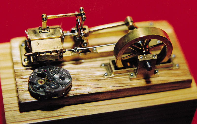

Or a little steam engine with a dynamo so if you were lost in the woods you could get wood to power up the engine and charge ur pandy!!
