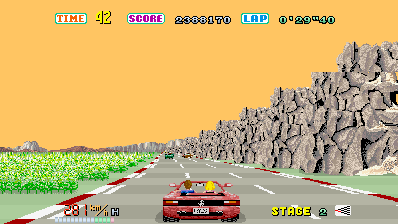

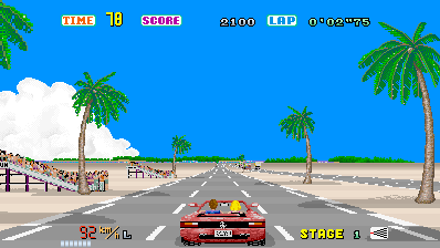

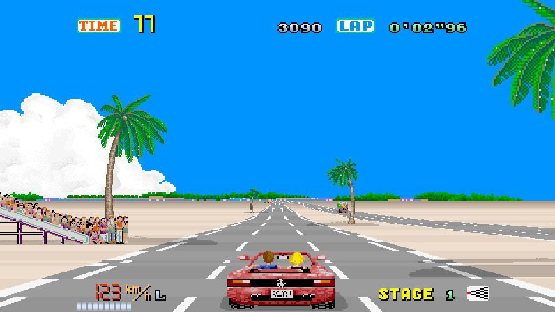

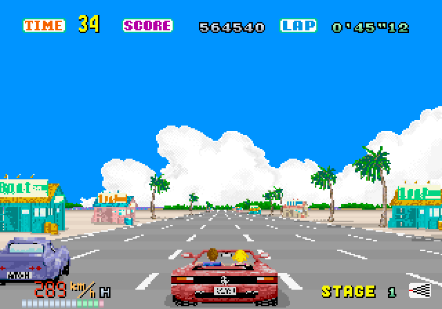

Some screenshots : preview1.png and preview3.png
And some more screenshots with Widescreen enabled : 121222-161426.png and 121222-161610.png

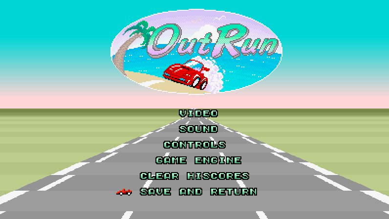

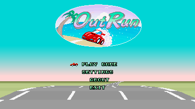

And a screenshot of the new Menu: 121230-201530.png 130121-225829.png

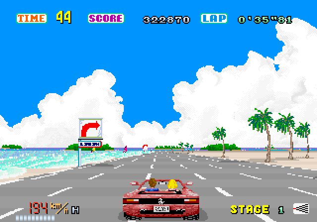

And a screenshot in HiRes mode:130121-225851.png

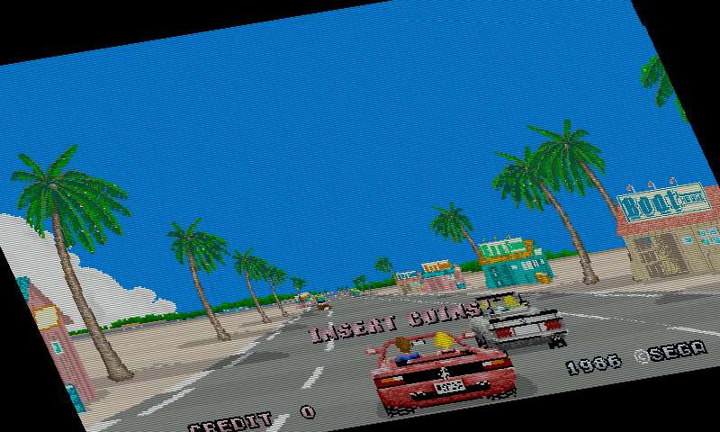

And an experimental GLES mode (in HiRes and with 50% scanlines):cannonball_1.png. And a video of the tilting
