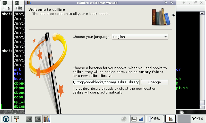

I finaly got the 1st screen wizard to show (it's a bit big for the screen, but not sure I'll do something about that).
I stil have many things to do to have fully working version, and even more work to PNDize it.

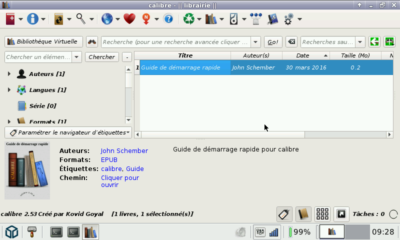

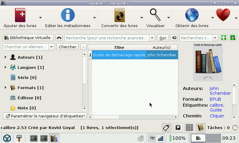

[doublepost=1459323027,1459322674][/doublepost]After changing a few preferences, choosing smaller everything, the GUI is a bit better for the small Pandora screen.

[doublepost=1459344006][/doublepost]I may have found a workaround for the reader connection. Not sure it's stable, needs more testing.
