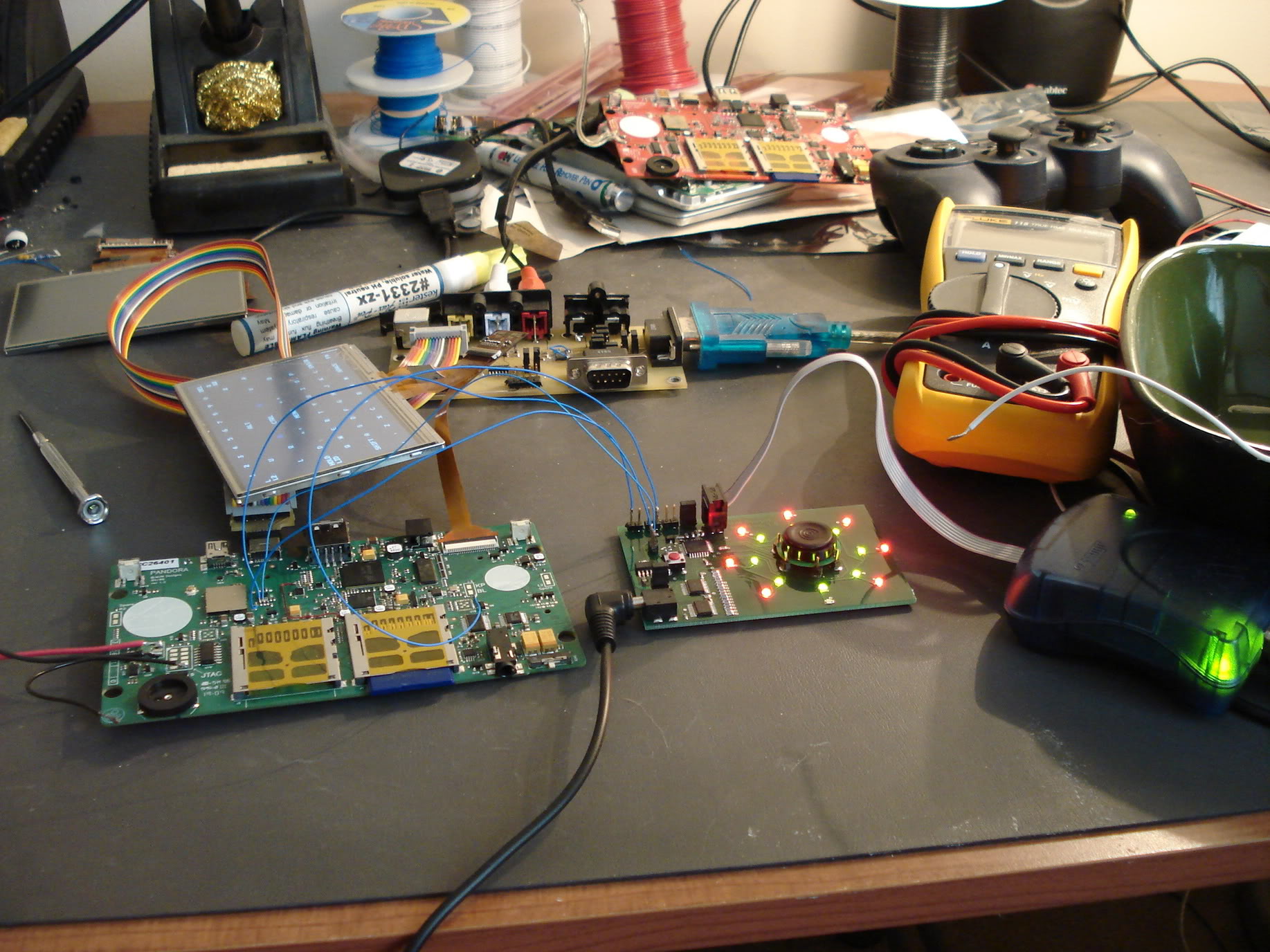

I did a little digging and I realized that the bread out board is actually breaking out the EXT connector on the back of the pandora. I had just assumed it was connected to an internal header. I guess the ribbon connector threw me but if you check this photo you can see there is a second board that converts the EXT connector to a ribbon connector that then connects to the break out board.
As far as all the connectors:
J1 - Audio In - 2 x RCA Connectors
J2 - Audio/Video Out - 3 x RCA Connectors
J3 - Serial female DB9 connector - Can be swapped between uart2 or uart 3 via jumpers
J4 - Serial male DB9 connector - Can be swapped between uart2 or uart 3 via jumpers
J5 - Can't tell for sure but mostly likely a mini-din connector for s-video.
J6 - 5x2 connector - Breaks out the alt functions allowing for GPIO on some pins.
