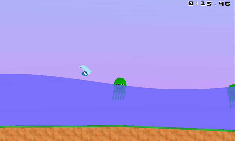

Here is a little game, involving physics, boats, aliens, and patience !
This is a port using gl4es.
A video of the gameplay on the Pandora by @ingoreis
The keys are:
DPad Left/Right : Turn
{X} : Thrust
{Y} : Reverse
{A} : Turn
{B} : Jump (you need to be deep in water to jump high).
Build 04
  • Now using gl4es
  • Corrected colors that where wrong (was still some left over of the GLES1 conversion)
  • Update screenshots
Build 03
  • Now using the awesome libGL by lunixbochs => faster and more compatible
  • Corrected colors that where wrong (didn't update screenshots)
Build 02
  • faster build (changed double to float)
  • Initial release
The modified sources are now on my github account: https://github.com/ptitSeb/bloboats
Lots of fun.
