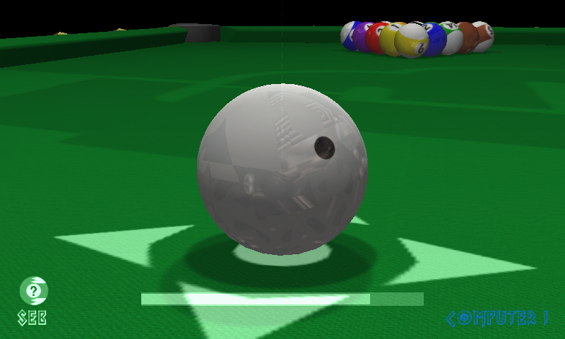

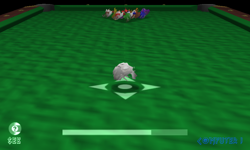

I still have issue, I think it's the glDrawArray with GL_UNSIGNED_INT inside Lists. I must have broken something when I fixed some textures conversion (also, the green part looks suspicious too).foobillard.png

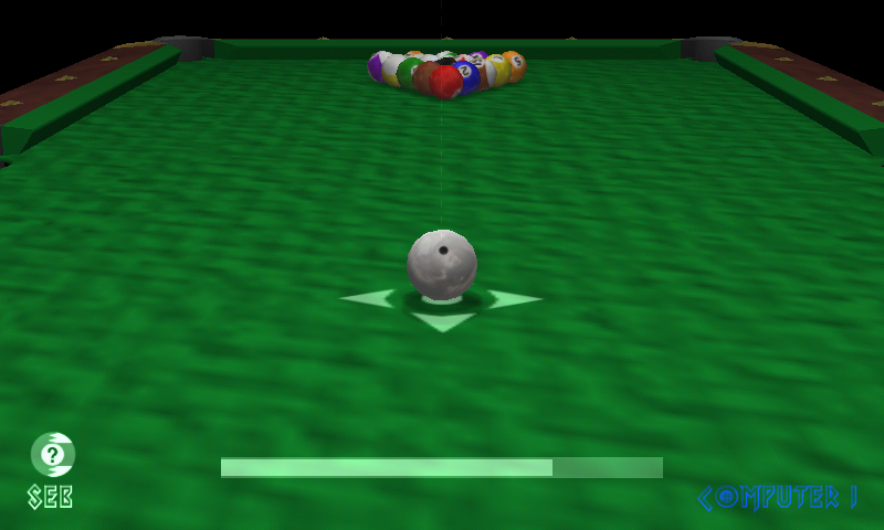

I hope it was a joke yes  :D  .. because release is approching: foobillard.png
Now, that that green texture seems wrong. I have to check on my PC with it is suppose to be like.

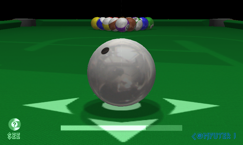

*EDIT*: There are 2 issue lefts: the Reflexion on the ball follow the rotation of the ball (problem with glTexGen inside List I guess) and the wavy green texture is in fact the detail texture, so it's supposed to be much smaller (pb with multiple Texture Matrix, with multitexture, inside List?).
Also, some advanced seting, like Redered reflexion on ball, just don't work (not sure it's easily fixable)... So still some wrk. Enjoy BillardGL in the mean time.
That looks like bumpmapping gone wrong... or a way too small texture for the whole table.

The broken balls were due the normalize_indices function : you should not remove "min" to all indice (at least not without changing the pointers too).
The other issues are within gltexgen stuff indeed. Both the Ball reflexion and the detail texture.
@lunixbochs: do you think GL_OES_texture_cube_map extension can help? I'm not sure if this extension alone add all the glTexGen we need.
I do change the pointer, via "arrays_to_renderlist". Maybe we should pass min instead of 0 there?

I have fixed the table (glGenTex=GL_OBJECT_LINEAR inside glList with Multitexturing) and most of the reflect (glGenTex=GL_SPHERE_MAP inside and outside glList, with and without Multitexture). So reflects on the table are fine. But the balls are not. Still something wrong somewhere... I go to bed and try to fix that tomorrow.
