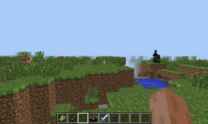

This is how I see the Minecraft world on my 1GHZ connecting to my server. Dunno what magic you've done ptitseb ;)
Using the recommended driver for 1GHZ and is a fresh flash.
At least it's a significant improvement over having no lighting at all and actually plays really nicely. :D

Go to video option screen and remove the MipMapping. It's not compatible for now, I have to find something. It will slow things down (no texture make it faster)

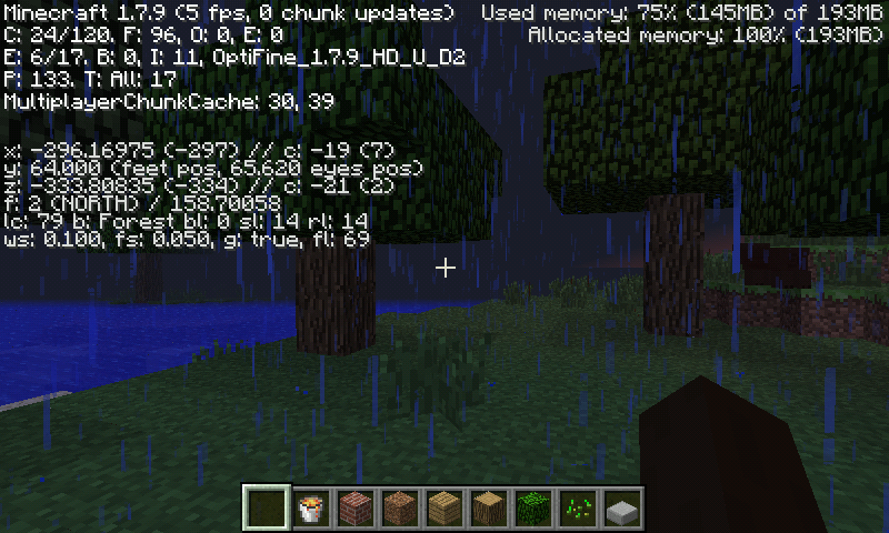

Like that  B)  ?

So awesome. I need to try this out shortly.
EDIT: Also what is your memory being spent on? Looks like you have less than 200MB available to Minecraft.
No it's just me that limited the memory to 200M with -Xmx200M (because I'm also compiling things, even if I pause the compilation when trying minecraft or other things).
