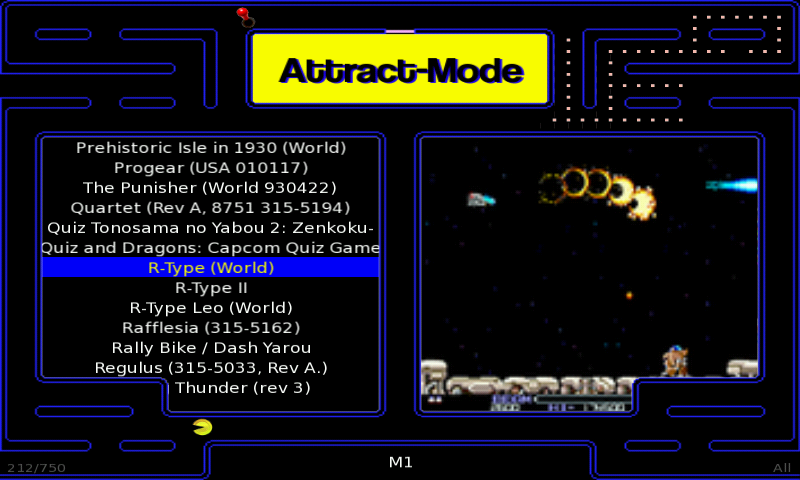

Here is Attract mode, a Front end launcher for many emulators.
This PND also included M1 (music player), Mame and Mess.
Attract mode use SFML2 and OpenGL. This version use glshim, but it's unfortunatly non-compatible with newer driver, so you should not use 4.04 and newer.
The Mame and Mess (and M1) version are based on  recent code, so it may not be as fast as Mame4All for example. But everything is included.
Note also that you need to configure Roms paths in both Attract mode (using the GUI) and Mame/Mess/M1.
I have tried to put some default config, but not sure it's a good idea. especially, the M1 emulator that comes as an empty list, it may crash Attract mode until you create a list.
I think there is a texture leak or something, so changing layout may lead to "freeze" that only longpress on Pandora button (kill of attract mode) can "solve".
Appart from that, it should be functionnal (beware the attract mode is not always simple to configure, the concept of List is a bit strange).
FYI, I have put mame and mess in the root (so use /mnt/utmp/attract/mame or just ./mame), m1 is called using ./m1.sh (not plain m1).

Quick test so far: MAME with snaps works fine.
Couldn't get MESS to work yet, since I don't know exactly how the thing with the different systems works with Attract Mode, so MESS doesn't know which system to use when I start a ROM.

Okay, played around with it a bit.
MAME works fine with snaps, MESS is working now as well with snaps and various systems.
Category filters are working fine as well.
Different layouts WORK, but you need to quit after choosing a different one and restart (though not every layout works).
I'm currently creating configs and setups for all usable MESS systems, when I'm done with that, I can send all that stuff to you and you can include it as default.
Then all the user would need to do is drop the ROMs and snapshots into directories, generate the list in Attract mode and everything is categorized nicely.
With usable emulators I mean playable. MegaDuck, e.g. works nicely (with a bit broken sound, but playable), whereas GP32 and Game.com runs with 3fps ;)
