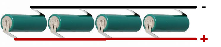

Could the cells be arranged like this?

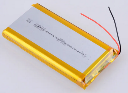

1B) or simply a single lipo (It's crazy how cheap those are when you buy ten, only ~7€ a piece at 10Ah)

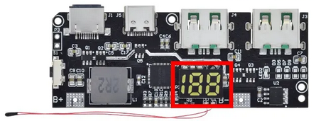

2) or this more expensive module that allows serial connection. The solder points for B1, B2, B3 are on the back.
Screenshot 2023-10-03 at 16-36-57 2.68€ 12_ OFF Qc4.0 Qc3.0 Led Dual Usb 5v 4.5a 22.5w Micro_t...png
I assume that would be easier on the cells because of less amps drawn. And more efficient in conversion as said in an above post.
This has a convenient percentage display. But in order for that to be accurate I'd have to replace a tiny resistor. It comes preset to 10Ah cells.

Yes you can parrallel the cells like that even the pouch cells , you may still want a BMS to avoid poorly charging the cells. That more expensive board is to add the batteries in series for 11.1V.

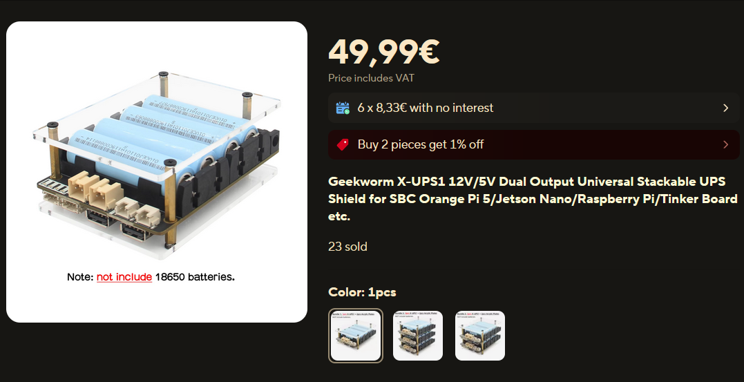

Next to the UPSPack V3 there's the Geekworm X-UPS. Another pretty neat project UPS. It can do 5 V and 12 V.
website blurb
Battery Charging
Supports 3000mA fast battery charging
Battery over current protection and over voltage protection
Protection of battery cell Reverse Connection
Lowbattery detection (LED and 3.3V level output)
Onboard 4 green LEDs indicate battery charging and discharging levels of 25%, 50% , 75% and 100%
18650 4cell lithium Ion holders
Power Input
Integrated highefficiency stepdown DC/DC converter
Wide 6V to 24V operating input range
Up to 95% Efficiency
Up to 10A output current to keep 3A fast charging and powering your SBC at the same time
Allows powering from a car, a solder pannel and other power sources
Most common power input jack: 5.5x2.1mm
Power Control
Onboard push button to control power on /off (PressON, Hold the button pressed at least 3s OFF )
Onboard LEDs shows the status of power output
AC power loss or power adapter failure detection (LED and 3.3V level output)
Jumper setting to enable Auto power on when power applied or restored
Jumper setting to disable 12V output
Ultralow standby power consumption to maximize battery life
Advanced system powerpath management avoids batteries frequent charging and discharging
Misc
Power output connectors : VH3.96 x2 (12V) / XH2.54 x2 (5V) / USB TypeA x2 (5V)
PH2.0-4P for external power switch
PH2.0-4P for low battery and AC power loss deteciton
[Specification]
Power input (Single board) : 6-24Vdc ±5%, ≥3A
UPS output voltage : 12Vdc ±5%, 5.1Vdc ±5%
UPS output current (Single boards) : Max 3A
UPS output current (Stackable boards) : 3A x No. of the boards
UPS charging current (Single board) : 2.3~3.2A
Terminal Battery Voltage : 4.24V
Battery Recharge Threshold : 4.1V
Battery low detection: ≤3V
