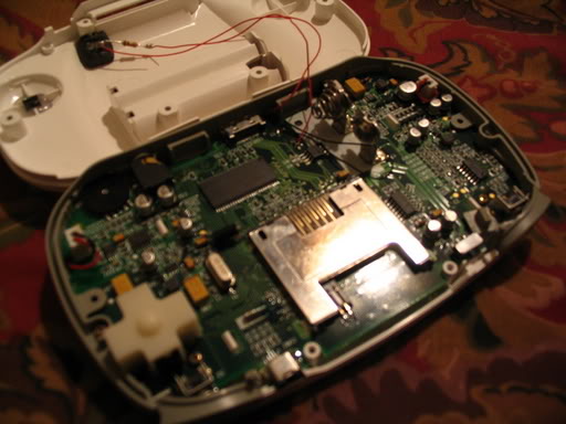

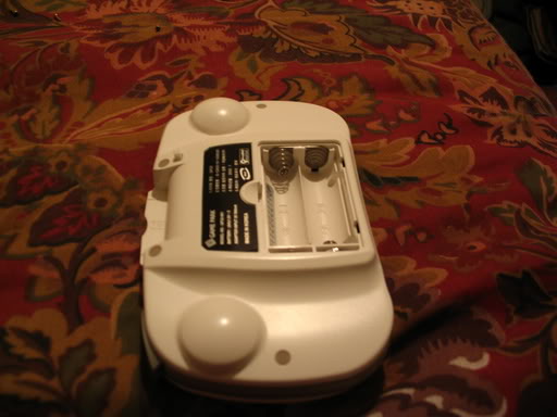

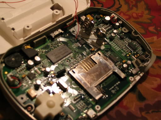

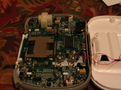

My GP32 stopped booting up with batteries several months ago and only works with a PSU. I've tried numerous different batteries (Made sure they weren't dead a million times) but none worked. I opened it up and looked around but I couldn't find anything wrong. Any idea on what might be wrong or what I should look for? Here are the best pictures that I was able to get:
See anything wrong? Thanks for reading.

The only times I have seen this happen is when people report accidently running batteries and a PSU at the same time, seems it does no harm on some GP32's but on others it causes this strange problem.

I had a little casio keyboard did the same thing.
I guess the PSU uses a different circuit to the batteries.
Follow the wires and check the connections.
Wiggle the wires with batteries inserted while switched on.

The psu jack has a switch in it that switches off the battery circuit, and this switch can become loose. Some people have stuffed their psu jacks with paper to fix this.

Yeah, like I said, but if you're too lazy for that, you can test if that's the problem
by plugging the ac adapter into the gp32, with the adapter unplugged from the wall, and the batteries in the gp32.
